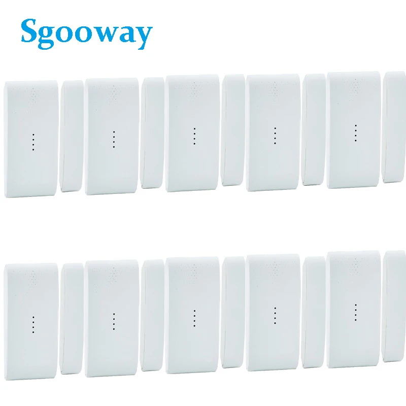

First of the rank is window sensors for securing the premises and giving people feedback on the state of the building for the last one out.
What I have in hardware is a bunch of these…
And one of these…
http://www.ebay.com.au/itm/251300811248
If anyone wants to take up the challenge in getting the sensors transmitting to the receiver that would be ace.
Hey I will put my money on the line and say if you get it working with 5 sensors to one receiver I will purchase the victor dinner…
