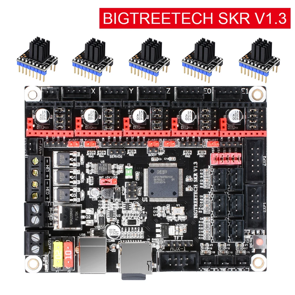

There is a new contender for the best value 32bit board though.
BIGTREETECH SKR V1.3 Control Board 32 Bit Smoothieboard TMC2208 TMC2130
Without modification, they unfortunately don’t slot right into a CR10 control box.
There is a direct upgrade which has been in the works for some time which fits directly into the factory box and uses all of the same connectors. I think it’s somewhere in limbo currently due to weird distribution problems, but it’s meant to be out soon
I a couple of weeks when I get a spare $50 I am going to buy one of the big tree tech things. I’ll report back on what I think of them. However everyone on the web that has had a look seems to be impressed.
