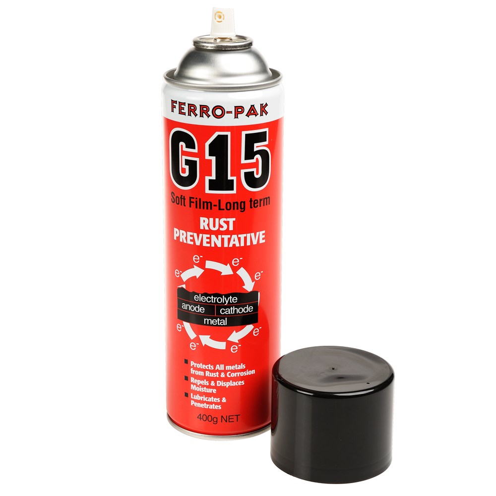

G15
Its what carbatec sells, I literally have no other information other than what they provide.
