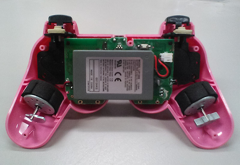

I had a PS3 controller with a dead battery. It still worked when plugged in, but when you removed the cable the controller lasted barely 5 minutes before it went flat. Rather than pay for a brand new controller, I thought I’d try just swapping the battery. First step - opening the controller to see what’s inside!
We can rebuild it. We have the technology!
This is a third-party controller with a different PCB to the official Sony ones, but it turns out it uses the same style battery. They both use a 3.7V 430mA Lithium-Ion battery with a handy-dandy connector. Nothing hard-soldered here! A quick look on eBay and I found plenty of drop-in replacements available, but I decided to go with something a little… bigger.
