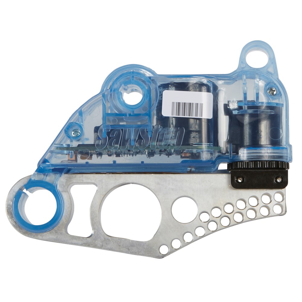

i just went to the sawstop website and during the purchase, they let you optionally add a number of things, and one of those is a “standard brake cartridge” which is priced at $130USD, that’s a lot less than the ~$500 you proposed, so maybe if your pricing is through an australian distributor, then the key is to pre-buy a couple of them with the saw and keep them for future event/s as a start.?
Carbatec has cartridges for $130 in Australia but you also have to replace the blade. So it would depend on the cost of the blade
Yep its $150 for the cartridge and $150-$350 for the blade. Hence $500. I do know what im talking about.
I would prefer a table saw that it easy to use a sled with and that can have the knife removed and replaced easily.
What would be the member responsibility if someone activates the sawstop break? I couldn’t afford to replace it if it went off and I would avoid using it or put it in bypass mode. What would be the rules of using the bypass mode? Do you think that people might be less careful knowing that their fingers aren’t on the line? If there is the possibility of members being required to put down a deposit to use the saw, I will have to vote against it as I would be ruled out of having access to the table saw.
I’d be more convinced about them if I saw a rigourous test of different materials that might get used to prove they aren’t conductive enough to cause it to break. Particularly recycled materials, plastics and composites materials. I haven’t been able to find anything like that online and that makes me wary.
from https://www.sawstop.com/support/faqs/
"What do I do if I activate the safety system’s brake cartridge? What will it cost to reset the safety system? Does activation damage the saw?

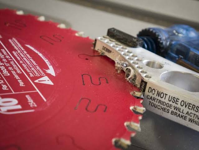

If you activate the safety system’s brake, you will need to replace the brake cartridge and evaluate the condition of the blade for future use. Replacing the brake cartridge is simple and can take as little as 90 seconds to complete. A standard brake cartridge costs $79 USD and a dado brake cartridge $99 USD. SawStop saws are designed to absorb the force of activation and are not damaged by it."
… so blade replacement is not a must-do according to the manufacturer.
It throws a massive chunk of metal into the saw blade. It absolutely does necessitate the replacement of the blade. If you somehow separate the blade from the brake, the blade will be warped and stressed from the impact and you will have teeth damaged and potentially ready to fly off.
Just because they put a sunny face on it doesnt negate the reality of what happens.

If you trip a saw stop it will cost the space somewhere between $130 and $500, after evaluation of damage.
Does that wording make you more comfortable?
Can the blade be reused if the safety system brake is activated?
When the safety system activates, it will sometimes damage one or more teeth on the blade. Some users discard and replace the blade, while others choose to have their blades inspected/repaired by a qualified specialist.
Thats from the manufacturer, theyre basically saying they make no guarantees, its up to your own judgement.
From my reading it seems to be about grounding, ie if a nail is in the wood it doesnt care but if that nail touches the table its then past the threshold. Same with green, very wet and or pressure treated timber, its got to get past whatever internal limit theyve set.
You can test materials in bypass mode, it indicates if it would have triggered.
