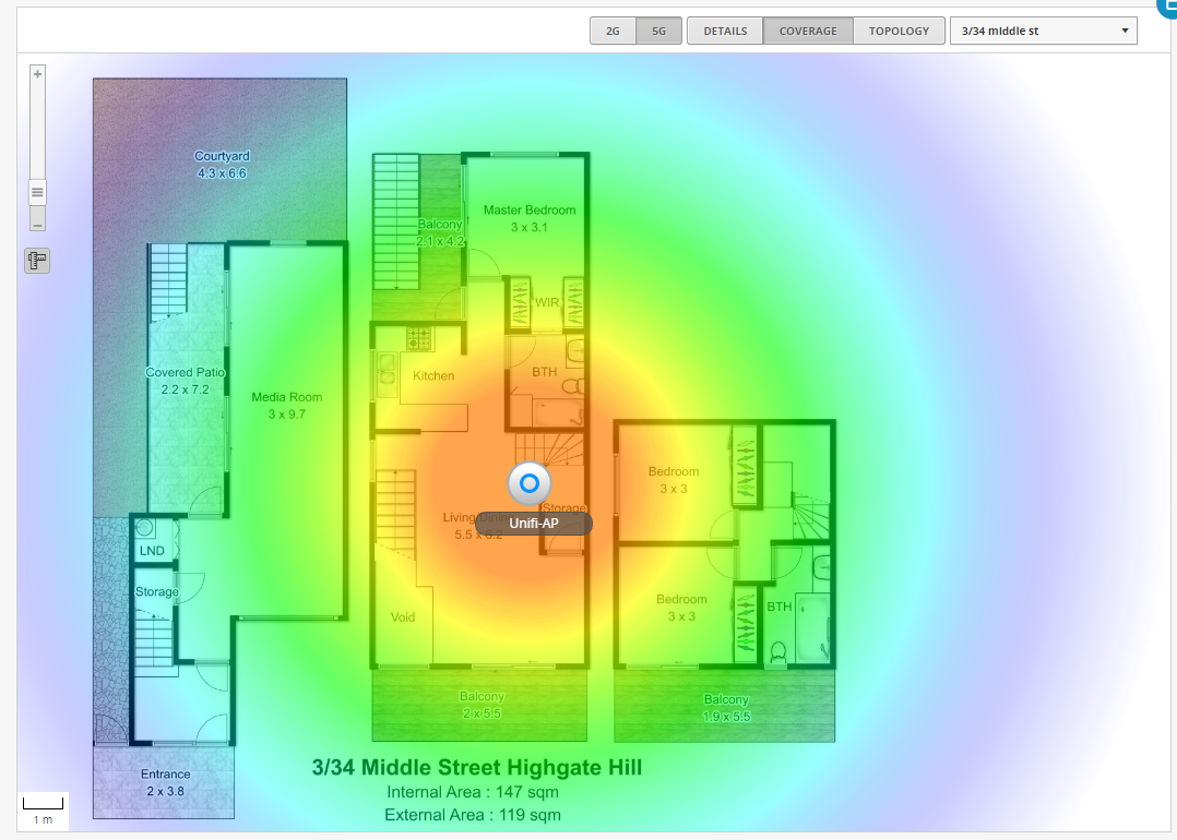

UniFi AP AC lite
This thing is a beast. Simple setup, comes with a 24v PoE injector, and has gear signal. This is also controlled with the UniFi Controller Server. This software has a small bug in that you must have Java7 not Java8 installed if using windows to run the server otherwise it wont pick up the AP.
Once I Installed UniFi Controller, I set up an account on the server. Input information about the LAN and created a WLAN profile, Adopted the AP device and bingo done. The IP’s are managed by the EdgeRouter so no problem there.

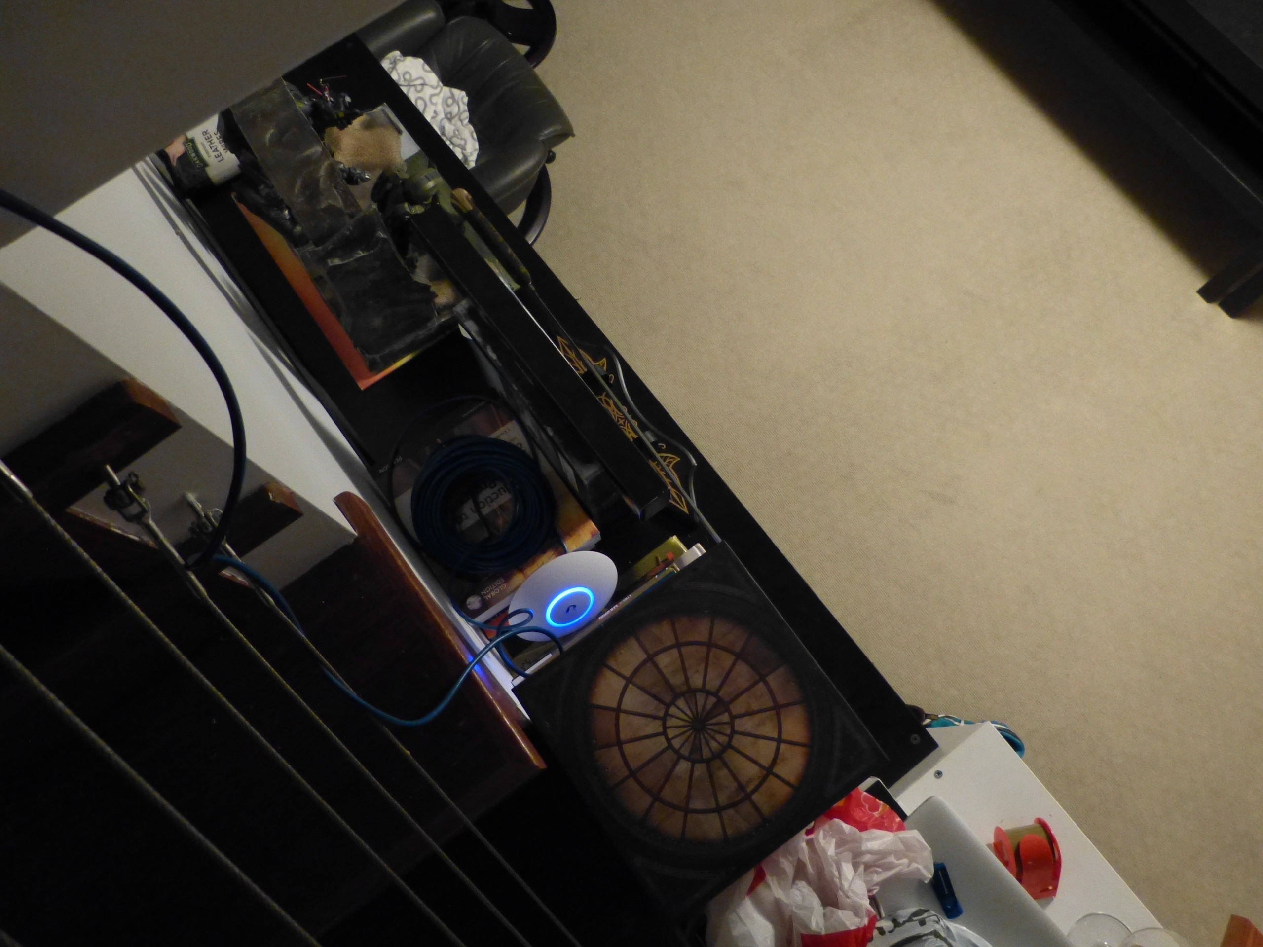

^ Ghetto Cabling, 30m lead
